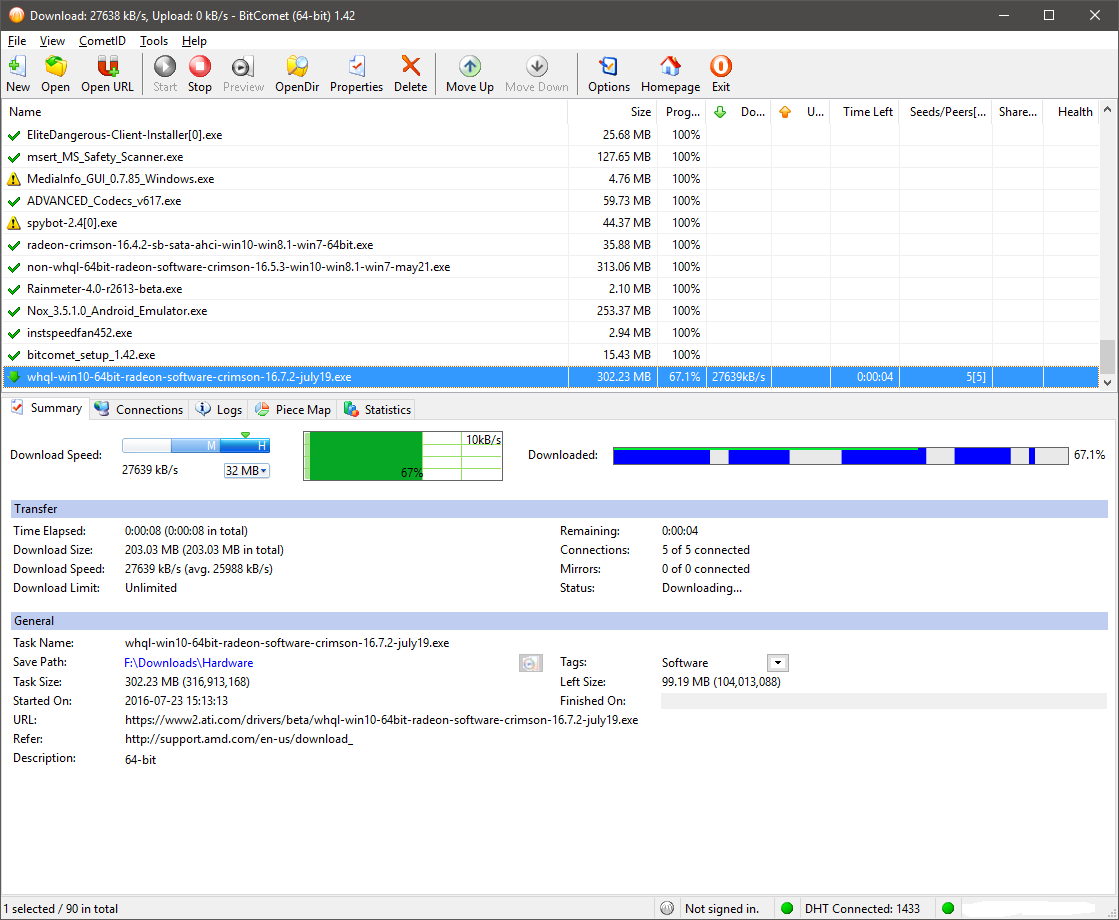

2. Not so much of a problem, just cosmetic, the Progress Graph when downloading a file bugs out when downloading faster than about 20Mb a second. As the download accellerates, the graph changes height to match and the speed indicator (number in the top right corner) changes accordingly until it gets to 17Mb/sec. It then goes back to showing 10Kb/sec and the graph is just one solid block.

Problem 2. Here's a screenshot of the graph when it goes wrong...
Hope this helps! :)
