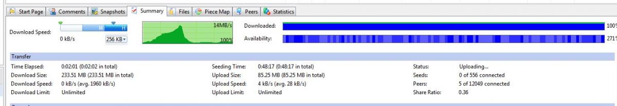

gasman Posted October 15, 2015 Share Posted October 15, 2015 (edited) Win 7 latest service pack. Bitcomet beta 20150629 Cable This is a recent problem, I am a seasoned bitcomet user and have my upload/ download limits set to optimum. I have all the green lights, However (see the attached) I recently noticed that my downloads are suddenly limited almost as if I was throttling my upload speeds and bitcomet "sees" me as a bad partner. I have my download set to unlimited and upload to 200kB/s yet am only achieving 5-6 k upload. connection is 120 Mb/s down and 12Mb/s up consistent . The results shown are with only a single torrent running after completion and no other demands on the connection. I suspect Mcafee but would welcome ideas Edited October 15, 2015 by gasman (see edit history) Link to comment Share on other sites More sharing options...

gasman Posted October 18, 2015 Author Share Posted October 18, 2015 Hi TUUS sorry for the belated reply but have been up to my neck. Good info re the Beta version, that did confuse me since I rarely run beta except for a quick evaluation. It seems I had an infection of some kind, I noticed the occasional dos pop up that appeared for a millisecond and not giving me time to read. I set up my video cam to watch the screen high res and it caught "taskeng.exe". Mcafee missed it but Malwarebytes seems to have eradicated it, time will tell. It wasn't just the one torrent that was doing this, but every torrent, The one shown was just an example. I still have to evaluate further as time permits but your input is always valuable and welcome. I will post more info as I get it. and update to 1.40 Link to comment Share on other sites More sharing options...
gasman Posted October 18, 2015 Author Share Posted October 18, 2015 Hurray, everything seems to be fixed since getting rid of taskeng.exe. Even tried going back to the problem torrent in my previous post and it behaved perfectly giving a download graph almost perfectly linear from start at 0 to finish at 14Mb/s. Think it would have gone on even higher had the file been bigger. Its my guess that taskeng was either blocking or using my upload slots. Have since downloaded BC 1.40 as you suggested but it wasn't easy. BC kept insisting I had the latest version already and would not install. I had to uninstall first and then install 1.40. Many thanks for your help TUUS, i hope the info re taskeng.exe was useful. I intend to dig deeper and bring it up with Mcafee Link to comment Share on other sites More sharing options...
