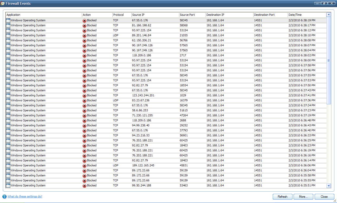

greywizard Posted February 3, 2010 Share Posted February 3, 2010 Actually, I don't know about the PC Tools firewall but my Comodo firewall is smarter than what you describe kluelos. Whenever I close BitComet it will start rejecting all incoming traffic on BitComet's listening port, as you can see in the screenshot below. So, I guess it's safe to say, it closes the port after BitComet's exit. Quote Link to comment Share on other sites More sharing options...

greywizard Posted February 4, 2010 Share Posted February 4, 2010 Oh, c'mon kluelos you're being discriminating now. B) Why should a hardware firewall, residing on a router, be entitled to close the ports when no application is any longer using them (by means of UPnP, I mean) and a humble software firewall should be denied that privilege? Of course, I'm not going to get into that argument about which filtering system is better (port based, application based, etc.) but I'm just stating the facts. If it can do it, I'm glad about it. Otherwise, should I be a paranoid security freak, I'd have to close the port manually, after each use of the client. Quote Link to comment Share on other sites More sharing options...
kluelos Posted February 4, 2010 Share Posted February 4, 2010 It's mostly the way it goes about it. I understand that it's good to keep the interface consistent (though IMO they've failed miserably at that elsewhere), but it implies that Comodo can route traffic that the winsock is going to route where it d*** well pleases, no matter what Comodo says about it. Quote Link to comment Share on other sites More sharing options...
greywizard Posted February 4, 2010 Share Posted February 4, 2010 I've run today a little test, just to clear my mind on that. I've downloaded the binaries of the eMule client, set its listening ports on the same number which my BitComet uses (which was closed of course) and started a few downloads. What I've discovered is that unless you specifically allow traffic to come on that port, towards this specific application, all incoming connections are blocked (irrespective of the fact that there is a rule in the firewall which allows traffic on the same port for BitComet - which was not running at the time). I understand what you say about Comodo trying to "route" traffic at transport layer. But I rather tend to think that the actual routing is still done by Winsock. What I believe Comodo's driver does, is interposing itself between Winsock and the rest of the system, intercepting the connections which were already routed and verifying them against its list of allowed applications and ports. When they don't match, it simply blocks the connection. Or maybe it stands even before Winsock and it intercepts and verifies the connections, I don't know. The point is, that I don't think it actually "does" the routing job or that it even tries, but rather it prevents the routing from being done if the connection doesn't comply with its list of parameters for allowed rules. Therefore, traffic is filtered also on an application level, which is good. Because, otherwise, just opening a port in the firewall (for any application which feels like registering in Winsock for it first) would be a pretty big security hole. My guess is that even Windows firewall does that at present time. Or else what would be the point of using application names in that list? It could just simply use port numbers. However, I don't feel like testing that too. :D Quote Link to comment Share on other sites More sharing options...
