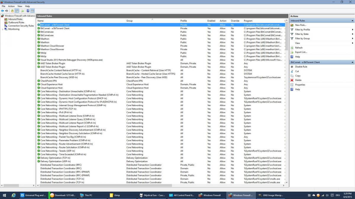

georgenistor Posted March 30, 2015 Author Share Posted March 30, 2015 Hi, Meanwhile I have solved it but I still have a question. Should I have in Windows Firewall -> Advanced Settings -> Inbound Rules -> BitComet.exe -> Properties -> Advanced in Edge Traversal put to Allow Edge Traversal ? Thanks, George Link to comment Share on other sites More sharing options...
The UnUsual Suspect Posted April 2, 2015 Share Posted April 2, 2015 Windows firewall exception is added automatically by BitComet Link to comment Share on other sites More sharing options...

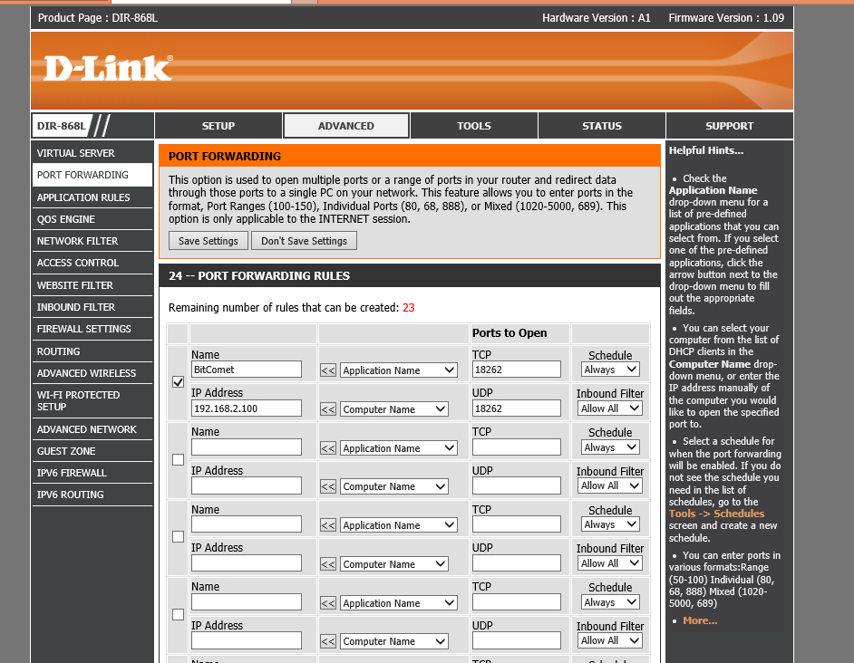

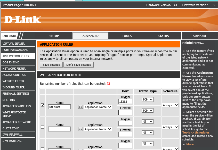

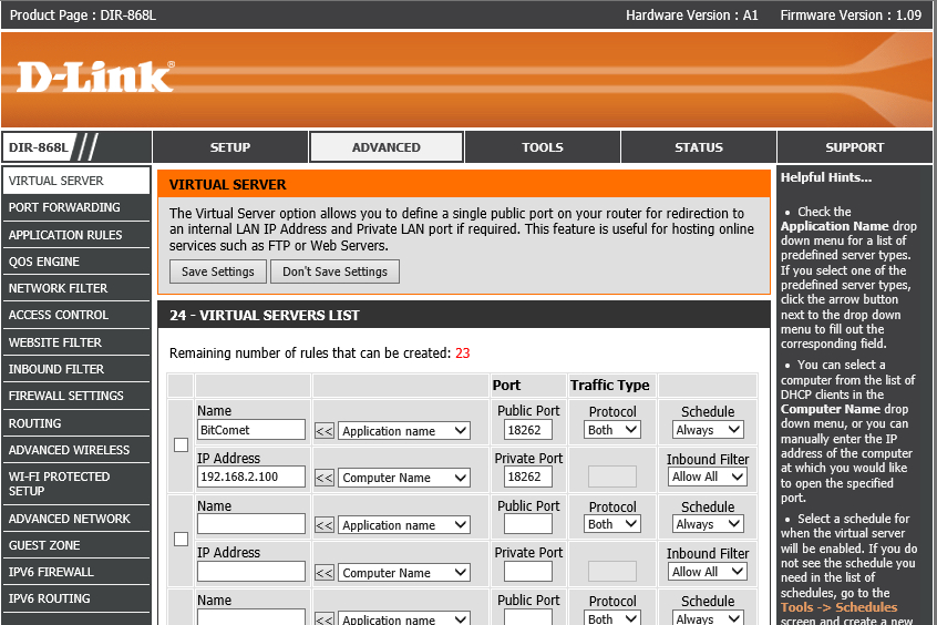

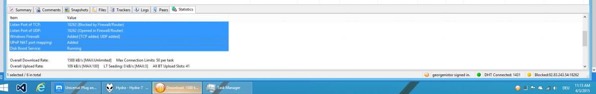

georgenistor Posted April 3, 2015 Author Share Posted April 3, 2015 Hello, I solved the problem with the UPNP, see the log below. The problem I have is I have Yellow light: I have a Huawey 658 router with UPNP enabled connected to the ISP on VDSL. I tried to connect dirrectly and all is detected UPNP and I have a Green light with WAN and the adress. I use a D-Link 868L connected on LAN 0 on the Huawey modem, and I connect on the 5Ghz network. All is auto, DHCP is on, UPNP active. The settings from the log are with the D-Link connection. But I still have that yellow that the port is blocked, slow download. I tried to add the PORT and my IP in the advanced settings in the Virtual Server, Port Forwarding and Application rules. All have allow on my fix port and my IP is put from the router list. The application settings does not require an ip, only the PORT specified. Can you help and tell me what I have to configure more. I folowed also http://wiki.bitcomet.com/add_port_mapping_in_nat_router#bitcomet_upnp_auto_port_mapping and done all for UPNP port mapping. Thanks, George Up Time: 0:42:30 Overall Tasks: Total: 6 / Running: 6 TCP Connections: Established: 92 [MAX:Unlimited] / Half-Open: 35 [MAX:200] LAN IP: 192.168.2.100 WAN IP: 92.83.243.54 Listen Port of TCP: 18262 (Blocked by Firewall/Router) Listen Port of UDP: 18262 (Opened in Firewall/Router) Windows Firewall: Added [TCP added, UDP added] UPnP NAT port mapping: Added Disk Boost Service: Running Overall Download Rate: 1566 kB/s [MAX:Unlimited] Max Connection Limits: 50 per task Overall Upload Rate: 110 kB/s [MAX:100] LT Seeding: 0 kB/s [MAX:3] All BT Upload Slots: 35 Memory Usage: Working Set: 1.12 GB, Commit Size: 1.23 GB Free Memory: Phys: 3.14 GB (Min to keep: 50 MB), Pagefile: 3.55 GB, Virtual: 131,070 GB Disk Cache Size: 1.13 GB (Min: 6 MB, Max: 1500 MB) Disk Read Statistics: Request: 15026 (freq: 6.1/s), Actual Disk Read: 406 (freq: 0.1/s), Hit Ratio: 97.2% Disk Write Statistics: Request: 211894 (freq: 87.8/s), Actual Disk Write: 401 (freq: 0.1/s), Hit Ratio: 99.8% Total Downloaded: 65.63 GB (this session: 3.52 GB) Total Uploaded: 3.52 GB (this session: 263.43 MB) Link to comment Share on other sites More sharing options...
georgenistor Posted April 3, 2015 Author Share Posted April 3, 2015 Link to comment Share on other sites More sharing options...
georgenistor Posted April 3, 2015 Author Share Posted April 3, 2015 I have deleted the rules from the Virtual Server and Application rules and I have added only Port Forwarding as in the link http://portforward.c...8L/BitComet.htm Still the port is blocked. I use DHCP on the ruter whch gives me prefered (always) 192.168.2.100 Link to comment Share on other sites More sharing options...

PetitDragon Posted April 3, 2015 Share Posted April 3, 2015 go to Windows Firewall setting and tick BitComet's both "Home/Work (Private)" and "Public" checkboxes. Link to comment Share on other sites More sharing options...
