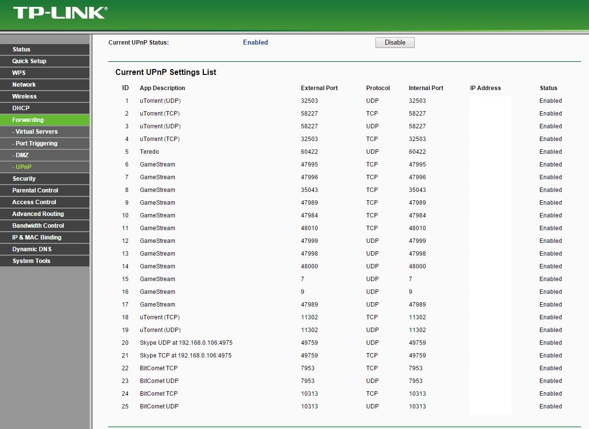

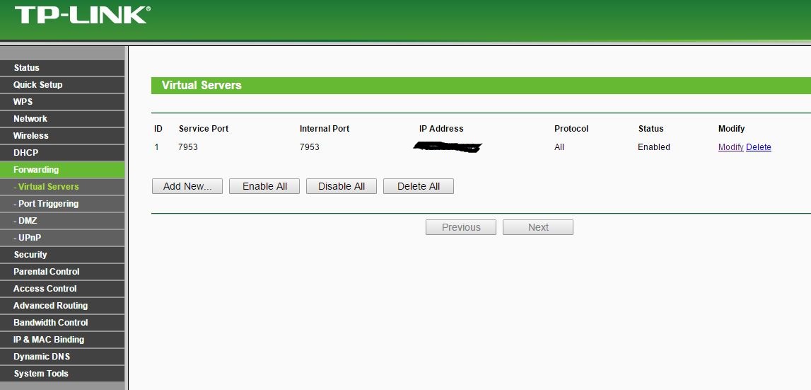

Hi,
I know the topic had many discussion earlier but I tried all the things that I could find in this forum to unblock the port i.e. Port Forwarding, Checking anti-virus for connection blockage, but all this didn't helped.
Bit Comet Version: 64 bit 1.38 stable release
Windows: Window 8.1 64 bit
Anti Virus: McAfee- Personal Firewall 14.6 version along with anti spam
Connection Type: WAN
Router: TP Link TL-WR841N
Multiple people are accessing through router at one time, all are having the same problem. Blocked port.
Please help me through this.
Adding to the above...
I talked to my ISP regarding this. He specified that the port will always be blocked no matter what. It's not allowed and there's no need to have a seperate listen port for 3rd party software.
Kindly help and suggest any solution.
