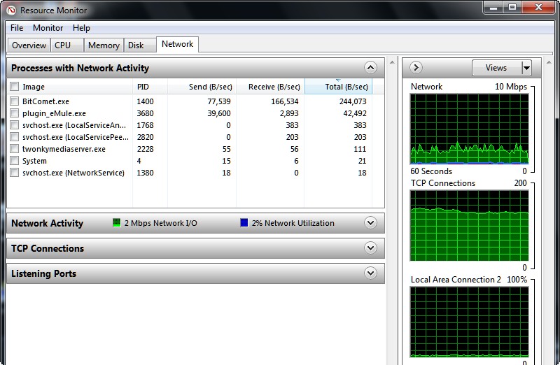

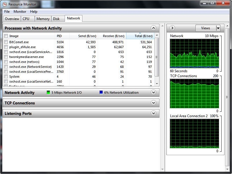

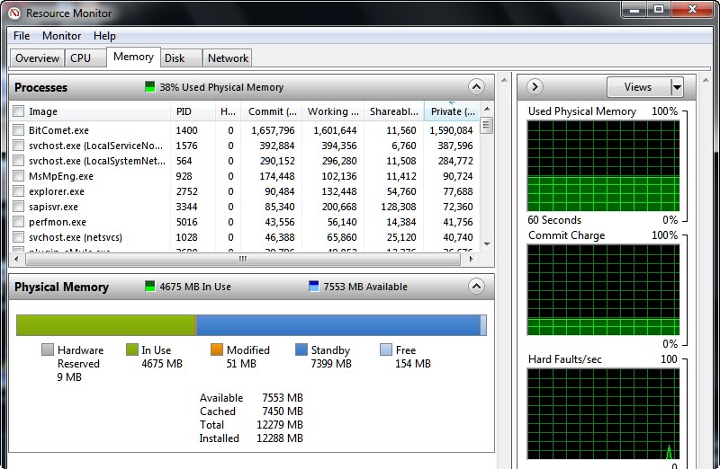

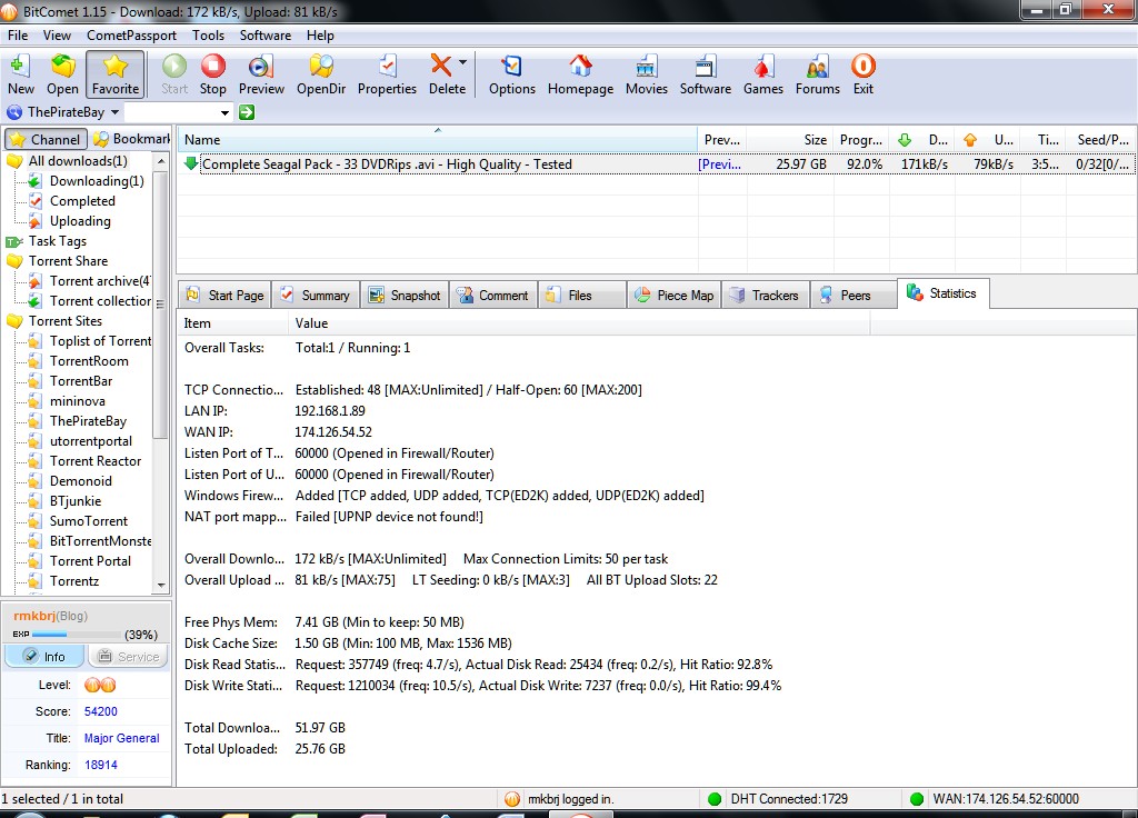

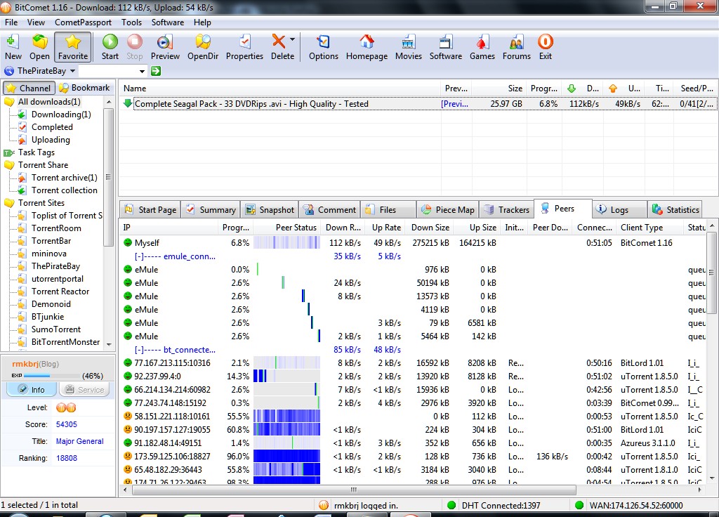

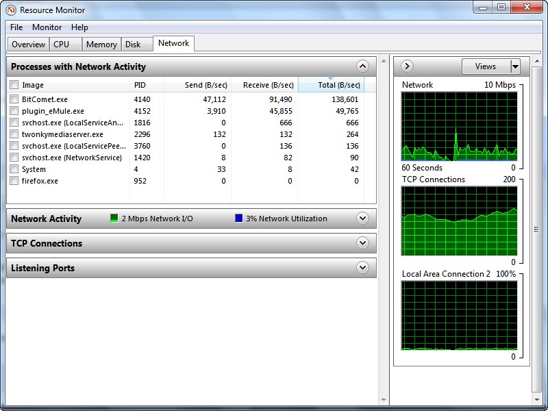

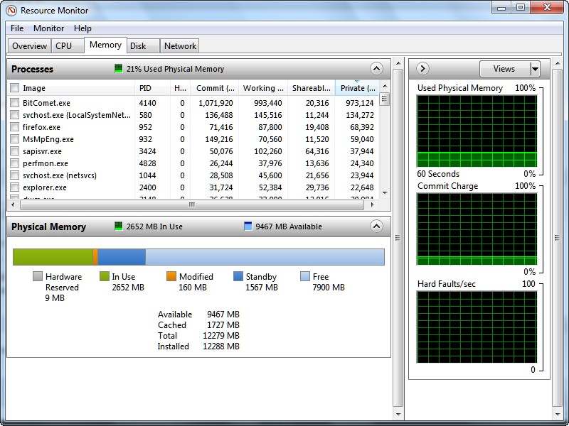

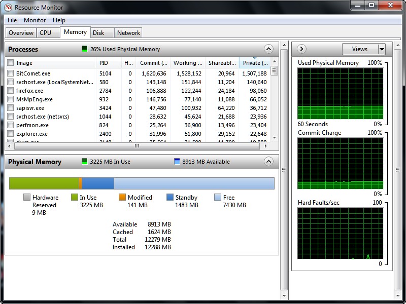

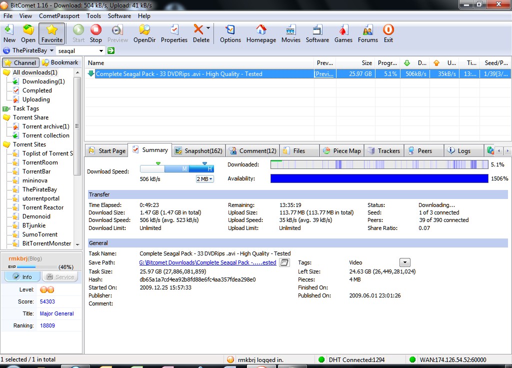

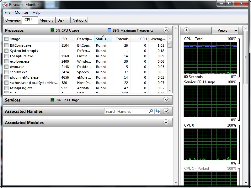

rmkbrj Posted December 26, 2009 Author Share Posted December 26, 2009 Here's the results: Attatchments 1,2 and 3 represent the status of bitcomet running 1.15 with LT on auto running stable last night. I uninstalled 1.15 cleaned up the registry, dumped e-mule re-booted and installed 1.16. I had backed up my settings and I imported them. Without any tasks running I was at about 23K on bitcomet. I started one task that I knew had substantial LT Threads. LT threading was set to auto. Time Storage 3:57 23K 4:00 95K 4:02 188K 4:04 256K 4:05 293K 4:12 484K 4:16 649K 4:23 865K 4:28 1000k 4:34 1200K 4:39 1500K 4:45 1620K and somewhat stable Downloading traffic went as high as 1200 kB/s and settled down at about 500 to 600 kB/s which I assume was caused by my provider balancing my usage at my max of 7M. Attachments 4,5,6 and 7 represent bitcomet after the above observations. I stopped bitcomet and started it again and logged off of passport. The climb in storage was observed to be about the same as the above figures. I stopped bitcomet and restarted it again. Turned off LT and stopped and started bitcomet again. Storage continues to grow with LT seeding off. 4:53 66K 4:56 300K 4:58 387K 5:00 450K 5:04 592K 5:08 670K 5:12 700K 5:16 765K 5:20 823K 5:26 884K 5:31 958K 5:38 1,018K 5:43 1,063K and somewhat stable Observations: Storage is rising to a peek in both cases but the level is much smaller without LT seeding. Seems to make sense since there are a smaller number of peers without LT seeding. It was observed that storage would fluctuate up about 8000K then drop back and build up to that increment then bump up drop back and build up again. I would assume this is the effect of committing the memory then using it after it is committed. Based on my experience, and I have quite a bit, it looks to me like the application either has memory leak of its own or W7 is giving too much memory to the application when it is requested. I would guess the latter but my experience is with large system memory usage not Windows. As above, Attachments 8, 9, and 10 are a representation of the system at the end of the last test phase. Hope this helps. Link to comment Share on other sites More sharing options...

rmkbrj Posted December 26, 2009 Author Share Posted December 26, 2009 Most interesting. I am running a single task (2 files) and the storage had crept up to about 220,000 K when I noticed that the disk cache was set at min 100M max 1536M and not on auto. I change it back to auto and the storage usage immediately dropped to about 180,000K. Based on previous observations apparently the cache setting was causing some of the extensive storage usage since the higher values observed were about the same as the max cache value. The higher cache value will also be more of a factor with tasks with many output files, which I run quite often. This does not explain why bitcomet would arbitrarily die when not enough storage was available just because the max cache value had pushed him to far or for that matter, any reason. It seems like scaling back storage usage would be a better action rather than just burping. Wow, good service today. The task I was running finished in 22 minutes (700mb). Bill Link to comment Share on other sites More sharing options...
