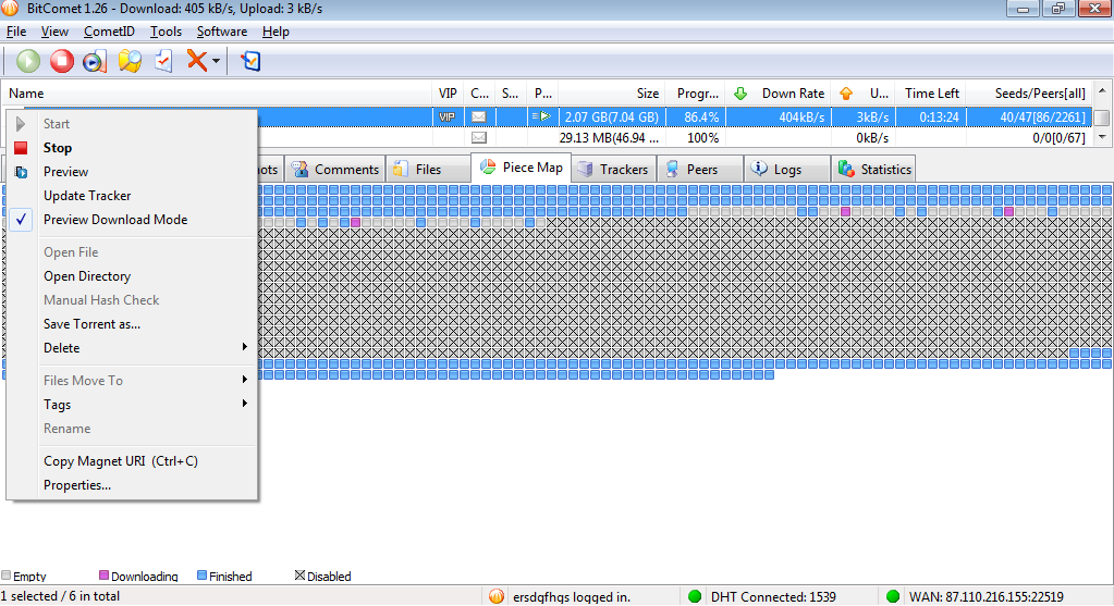

I'm attaching two screen-shots here for your amusement; I hope this will help to identify the problem.
Well, so far we haven't established yet that there IS a problem. The screenshots you posted are not very clearly indicating that situation either, since most of the files for that torrent are disabled.
If you want to present proof of a bug you'll have to do that with torrent s that don't have most of the pieces disabled and also you'll have to be able to reproduce that in more than one torrent.
As I was explaining above, this option doesn't GRANT you absolute sequential download order for pieces (BitTorrent protocol just wasn't designed for that) but a best-effort behavior from the client's part.
It's very possible that the scattered pieces which can be seen in your screenshot may have been downloaded at moments when all the peers/seeds which may have served the next sequential pieces to your client were choking you. So you client was faced with the choice of either sitting idle waiting for any peer to serve it the next sequential piece or taking any other piece which was available. In that case, the logical and most productive choice is the latter, hence the few scattered pieces you can see.
I'm not denying 100% the possibility of a bug, just saying that what you presented may have very natural causes. In order to prove a bug of this type you need to watch closely the Piece Map and Peers tab during the whole download. If while the seeds connected to you are NOT choking you, you still download ONLY scattered pieces and no sequential ones, then and only then can there be talk of a bug.
I hope you can understand now why this is a rather time consuming operation and not a very easy to carry out one either.
In addition to the afrorementioned torrent, which is season 3 of some TV series, I've tried to play also with season 2, a similar torrent with about the same number of files, file size and even seeds. So:
[s3] This is what happened when I enabled all the rest files of the torrent I spoke about earlier;
[s3] This is what happened when I deleted all the files of the said torrrent and tried donwloading a single file -- now it worked! (As I've pointed, it didn't work before) I believe the difference between this two states of a single torrent clearly shows that something has gone wrong.
[s2] This is what happend when I started downoading season 2--a very similar torrent;
[s2] This is how it progressed and
[s2] What was it like in the end... It somewhat works.. Or not?
[s2] A single file downloads in the same way as in [s3]

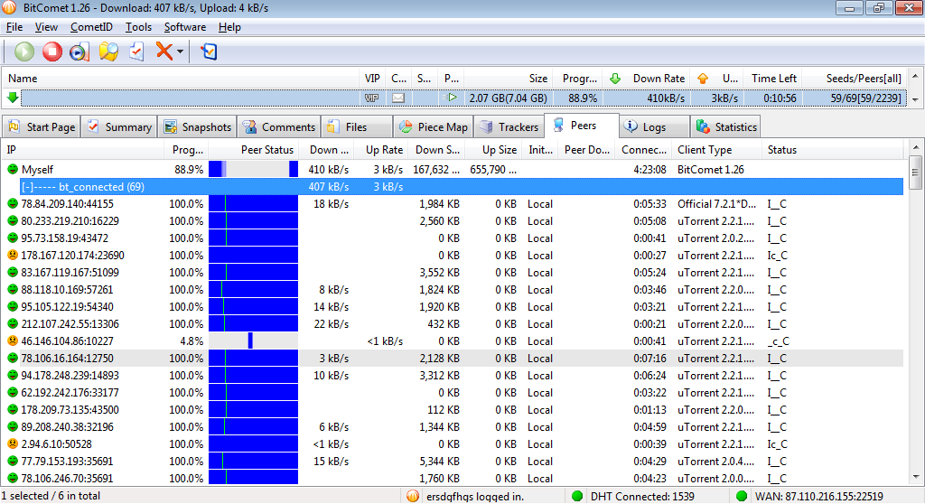

The peers tab looks either like this or like that, depending on the LT Seeds option.

Static screenshots can't constitute much proof of anything in this matter, from a logical standpoint. If at the moments when those scattered pieces were downloaded BC didn't have a better choice available, then it made the best choice possible by downloading them instead of standing idle.
While to you it may seem that the composition and behavior of a torrent swarm is something stable, you couldn't be farther from the truth. Think of the high entropy of a heated gas in the physics/chemistry lessons and you'll get a closer picture of the dynamics inside a torrent swarm.
You can't compare the behavior of your client in two different moments in time because you'll never be able to reproduce the same parameters twice; you'll always be comparing, more or less, apples to pineapples.

The screenshots I posted are merely visualizations of my words which only serve the function of proving that I'm (hopefully) not a complete idiot. Tbh I don't really know how do I learn "how many peers did my client connect/disconnect per minute in each instance", but what I do know is that I've spent a good time looking at "Piece Map" tab (as I've got two monitors and can watch a movie on another) and I've seen enough to say that sometimes restarting BC helps and sometimes choosing another file helps, and in ALL cases the difference between "it's working" and "it's not" is so huge that I can assure you that there has been no state (not taking one of the mentioned shots in account) when BC "downloaded SOME of the piece sequentially while downloading some random pieces". In other words, you are saying that exactly 100% of seeds I want to download from in sequence choke me. If I get the things right, that is.
If restarting BC or choosing the next file (a matter of minute!) in a swarm of hundreds of seeds really can make such a difference, then I don't have any more questions. I know that bittorrent protocol doesn't implement streaming (yet?), but when BC succeeds at it, it works flawlessly enough to make me think that when it doesn't, it's a bug.
To answer the points I can (as evident from the screenshots):
  • how many of the connected peers were seeds or peers? about 60 of 70 or so
  • how many of the connected peers that were seeds were choking your client and for how long? about 5 / don't know. Almost all of the peers are I__C
And.. why are non-seeds so important?
