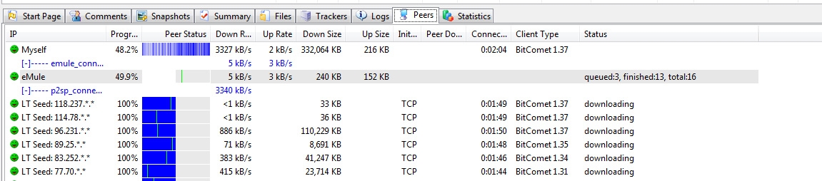

The UnUsual Suspect Posted February 9, 2015 Share Posted February 9, 2015 Here is a screenshot showing emule uploading After the download completed my upload speed to the peers increased, it's still only about 20kB/s but I suspect these two peers are very slow as I rarely got more then 2-3kB/s from them. After waiting about half an hour I enabled LTseed and the torrent completed in a few minutes. If you like you can try redownloading the torrent, start it, remove all the bittorrent trackers, disable DHT and disable LTseed so it will only download from emule and we can see if my upload speeds up. It will probably be best to shut down all other torrents so our test isn't competing for bandwidth. Quote Link to comment Share on other sites More sharing options...

The UnUsual Suspect Posted February 9, 2015 Share Posted February 9, 2015 I'm using the latest emule plugin with no modifications. If you want to try to see if you're able to download from me please do so soon as I will be deleting this torrent shortly. Quote Link to comment Share on other sites More sharing options...
