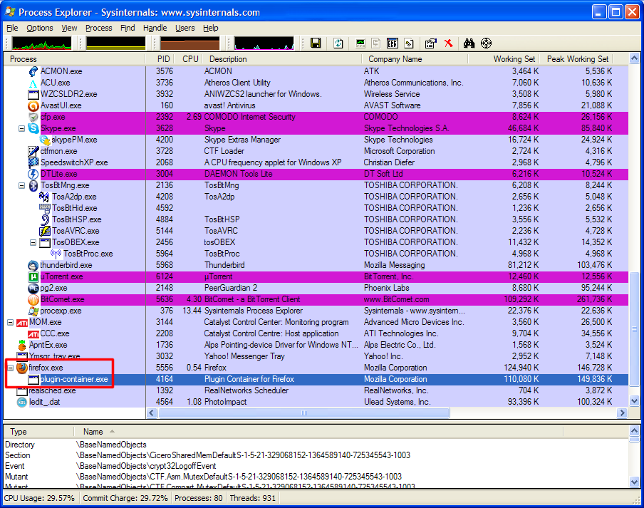

greywizard Posted July 14, 2010 Share Posted July 14, 2010 On 7/14/2010 at 5:56 PM, imajinn said: firefox does not have this sub process called plugin-container.exe... Really? Take a look below then. Link to comment Share on other sites More sharing options...

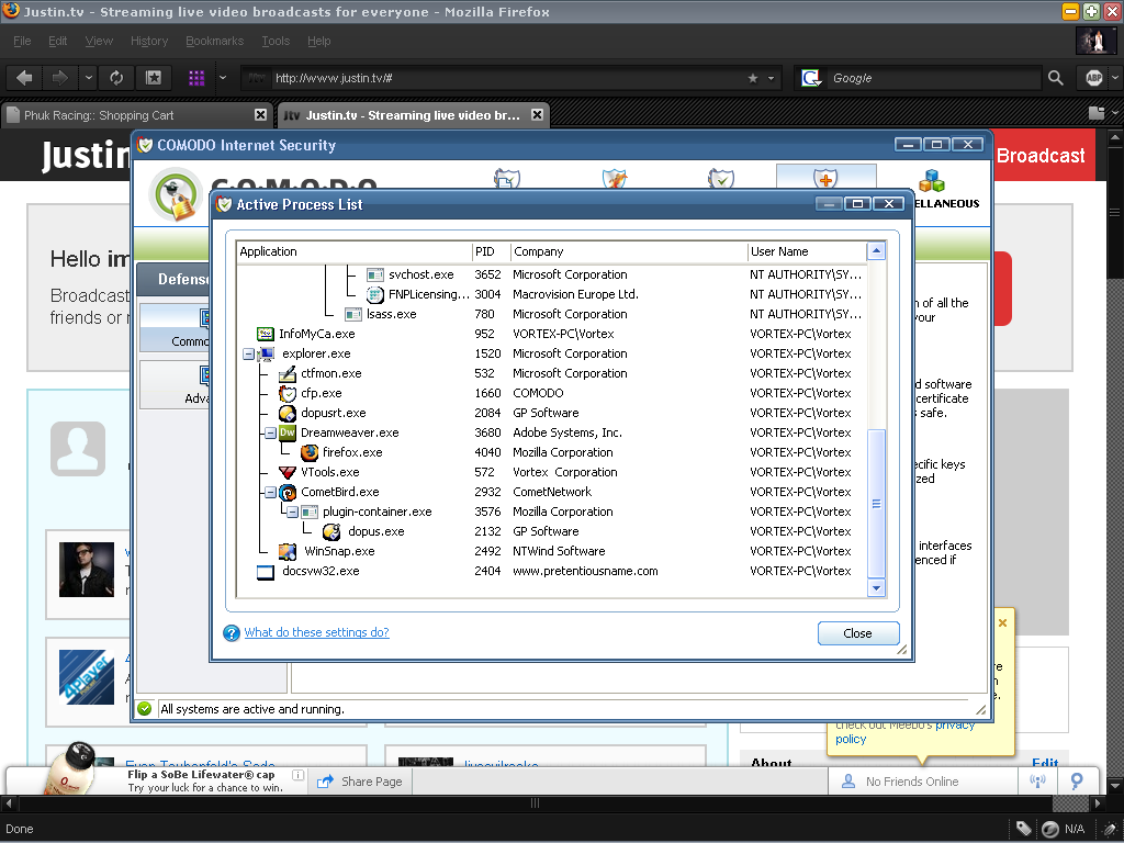

imajinn Posted July 16, 2010 Author Share Posted July 16, 2010 (edited) Please understand that I am not complaining but more wondering My version of Mozilla is 3.0.15 so I don't have the plugin process running. Please, see attached file. Still have an issue with login in cometmarks. I am redirected to CometID. Can someone help me login again? The online bookmarking is really great but cant use it for about 2 weeks now Thanks Edited July 16, 2010 by imajinn (see edit history) Link to comment Share on other sites More sharing options...
