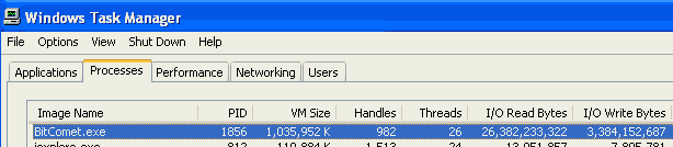

bc65536 Posted July 27, 2010 Share Posted July 27, 2010 Hi, BitComet on my machine sometimes uses more memory than I think is appropriate and commit size grows over time rather than reaching steady state. (E.g. Over 1 GB commit with 512 MB physical.) Is this a known problem? I did not see other posts or notes in the FAQ about this magnitude of memory usage. Are debug symbols available to help identify the cause? Sometimes BitComet.exe will consume less than 200 MB after running for hours, but sometimes it grows excessively. For example today after about 12 hours the VM size as shown in Task Manager is 970708 K. It is not a leak because when exiting cleanly the commit size comes down to 32 MB at the point kernel32!ExitProcess is called. The current BitComet rate is roughly download 2 kB/s, upload 85 kB/s. Versions: OS: Windows XP (Version 5.1 build 2600.xpsp_sp3_gdr.100216-1514 : Service Pack 3) Physical memory: 512 MB BitComet: 1.22. eMule plugIn: 1.22.6.8 Router: NetGear WPN824v2 BitComet settings: Global max download rate: 9999 kB/s Global max upload rate: 80 kB/s Listen port: set to same as value in router, Statistics pane shows port as opened Enable UPnP port mapping: on Enable Torrent Exchange: on eMule plugin: Installed, enabled Appearance/Default task info tab: statistics (and tab for "start page" is not visible) Shrink disk cache size if free physical memory is lower than: 80 MB Thanks Link to comment Share on other sites More sharing options...
The UnUsual Suspect Posted July 27, 2010 Share Posted July 27, 2010 I personally haven't seen any similar reports about 1.22, and I'd say unless your running an extreme number of tasks, this is highly unusual. For question I can think of. Is this behavior new to version 1.22? or have you experienced it in prior versions? One thing I have seen is when an excessive number of stopped tasks are uploading on LTseed, like 100 or more, it can use excessive amounts of memory and many users don't understand LTseeding and expect bitcomet to be idle when tasks are stopped. As a test, you can simply disable this option and see if the excessive memory usage stops. If it does, then you just have to better control how many tasks you allow to LTseed. If this is something new since installing 1.22, reverting back to a previous version would be an option. It's impossible to test all new versions on every possible system configuration, connection, and usage, so some incompatibilities will surface from time to time. Link to comment Share on other sites More sharing options...
bc65536 Posted July 27, 2010 Author Share Posted July 27, 2010 Your advice worked great! After many hours the commit size is only about 56 MB. I turned off "enable long term seeding". For LTSeed there seems to be only a rate control, with units kB/sec. Is there a way to directly control number of LTSeed tasks? Next I can try limiting network.max_connections and enabling LTSeed. Thanks! Link to comment Share on other sites More sharing options...
