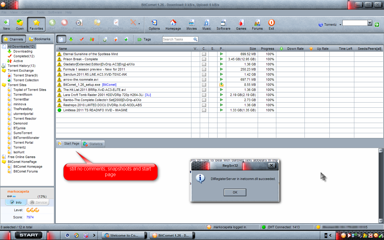

No I do not use IP filtering pr. . The problem appeared a few days ago, and until then it was all ok. even when Windows starts, Bit Comet will not start up automatically as before, but I have to manually start. even removed Bit-Comet and reinstalled but still no luck.

I do not use IE, but I'm on Chrome or Comet bird. I have not touched any settings on them. Is it perhaps possible that, tune up utilities 2011 somting mest up? but this program I installed a 1 months ago and all is working ok, but the problems begin a few days ago., only program I have instaled the last few days is a mozilla fire fox 4!!

Hi Marko, we have related =inetcomm#what_to_do_when_garbled_text_appears_in_the_cometid_pane"]WIKI instructions on how to deal with garbled text appears in the CometID pane.
What to do when garbled text appears in the CometID pane
This problem is usually caused by the corruption of Outlook. You may also find that any .mht file can't be open by IE correctly. Please try Method 1 first, if the problem still exists, please then try method 2.
Method 1:
Step[1]: Windows Start menu → run → regsvr32 inetcomm.dll
Step[2]: If last step failed due to missing inetcomm.dll, try to restore it from c:\windows\system32\dllcache\ to c:\windows\system32\
Step[3]: Repeat step[1], if still faild due to “module missing”, try to find msoert2.dll and inetres.dll, copy them to c:\windows\system32\
Step[4]: Repeat step[1], and it should work.
Method 2:
Download the mht file from HERE, extract it and double-click the file named mht.reg.

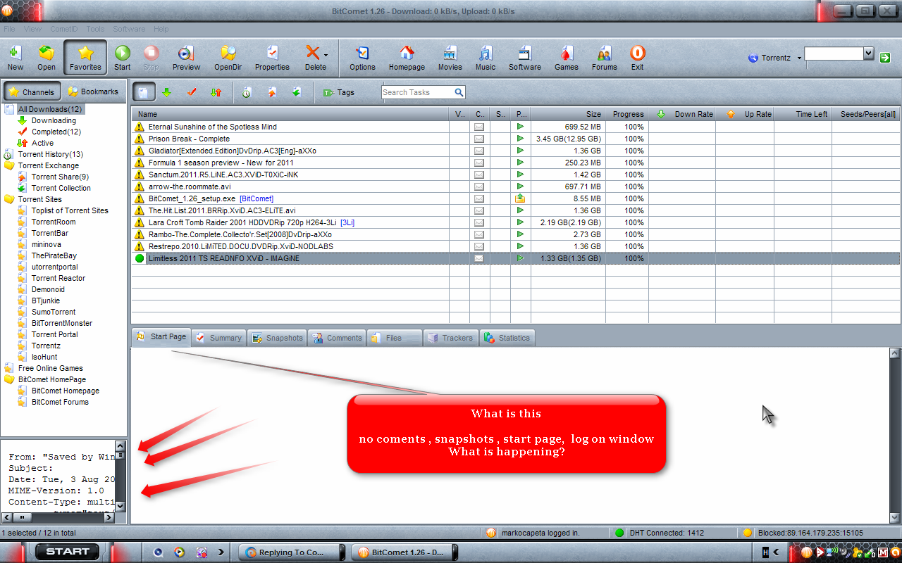

ok we succeeded to solve half the problem. I try Method 1 first, but the problem still exists, then I try method 2, and i succeeded to recover the log on box, but still remained comments, snapshoots, start page, and why not program starts along with windows?
