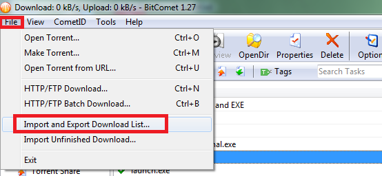

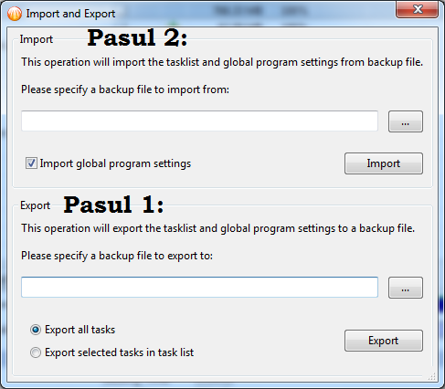

Vasy Posted June 19, 2011 Share Posted June 19, 2011 Asa cum a zis TuuS, mergi in meniul file de unde-ti alegi "Import and export download list" si apoi Pasul 1: inainte sa reinstalezi windows-ul faci un export la toate setarile si sarcinile pe care le ai, iar Pasul 2: dupa ce reinstalezi windows-ul instalezi BitComet si tot din acelasi meniu alegi fisierul facut pentru a importa totul: Like TuuS said, go to the "File" menu, where you can select "Import and export download list, and then Step 1: before reinstalling windows you need to export all tasks and settings to a file, and Step 2: after reinstalling windows and installing BitComet, go to the same menu and select the above mentioned file to import everything. Link to comment Share on other sites More sharing options...
