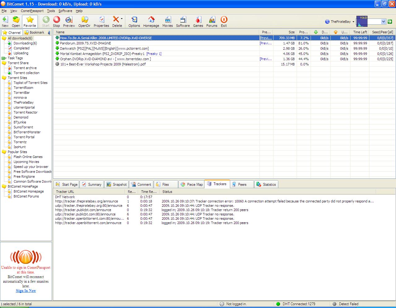

Apasa dublu-click pe una din sarcini, asteapta 30 de secunde, si da-ne o poza cu tabul "Trackers", nu "Summary".
Double-click one of your tasks, wait 30 seconds, and then give us a screenshot of the "Trackers" tab, not "Summary".

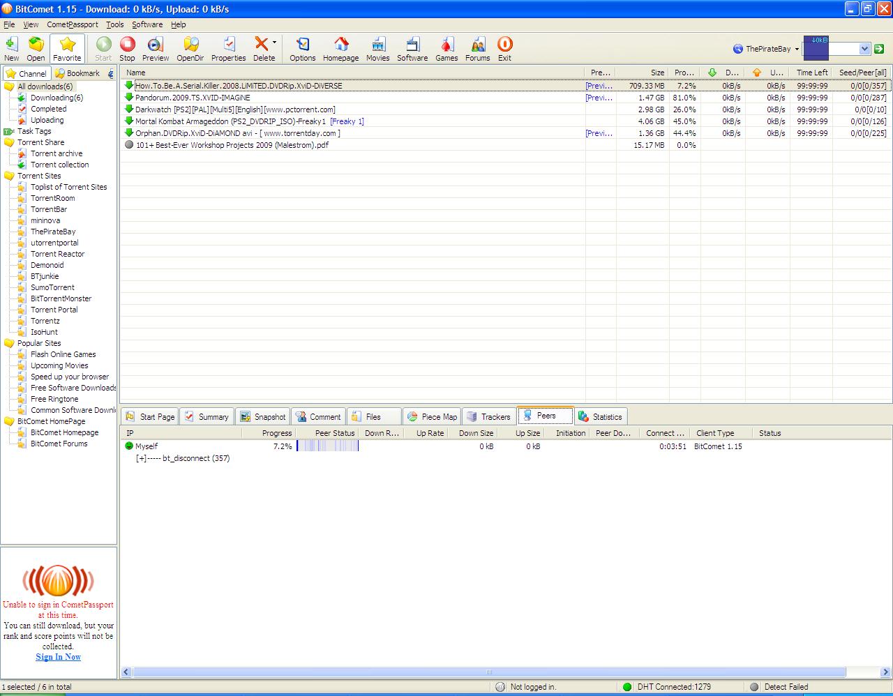

Hmm. I certainly do NOT see all the peers that you are talking about. In fact, I don't see any at all. All of your tasks, including the marked one, are stopped. When a task is stopped, BC doesn't make any attempt to keep track of what the swarm is doing. There would be no point to this.
Start one of the tasks. Let it run for a few minutes, while you look at the TRACKERS tab. You should see replies from each individual tracker, and if the torrent is public, from DHT as well. When you do see all of the responses, take a screenshot of that.
Then look at the PEERS tab. Take another screenshot.
Post both of those.
Cu siguranta nu vad partenerii despre care vorbesti. De fapt, nu vad nici unul. Toate sarcinile tale, incluzand cea selectata, sunt oprite. Cand o saarcina e oprita, BC nu incearca sa monitorizeze multimea. Ar fi inutil.
Porneste una din sarcini. Las-o sa mearga cateva minute, cat timp te uiti la coloana TRACKERS. Ar trebui sa vezi raspunsuri de la fiecare tracker in parte, iar daca torrentul e public, si de la DHT. Cand vezi toate raspunsurile, fa-le o poza.
Apoi uita-te la coloana PEERS. Fa o alta poza.
Posteaza-le pe amandoua.

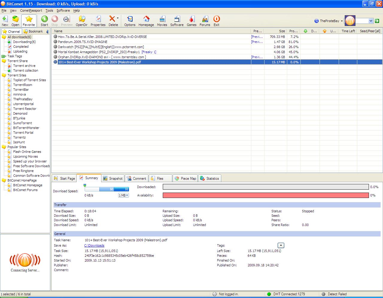

The first point to notice here, is the number of tasks you are running: far too many. When you do this, they all have to compete for upload bandwidth with each other and with all other applications. Any one task therefore does not get very much of it.
The other peers connected to you, do not see your overall bandwidth. They see only what the particular task you are both connected on, is getting. In your case, that won't be very much, and that would make you an undesirable partner. After a time, everyone in the swarm will have given up on you.
The second point is to look at what the tracker(s) are telling you. For the first task here, most of the trackers are not connected. This is the current set of TBP issues, and it's unknown when they'll be cleared up. The suggested public alternate sites are responding, and each is reporting 200 peers. These are almost certainly the same 200 peers, and illustrates why using multiple trackers is usually a waste of tracker resources. They're each duplicating the other's efforts.
Your screen does not show a response from DHT. I'm not sure what this reflects in this version. It should either report the number of peers, or state that DHT is forbidden. Up in the task summary, there are 327 available peers reported. Let's for the moment assume that the other 127 came from DHT.
Notice, however, that there are no seeds at all. This is ominous. It MIGHT have an innocent explanation, that this is a very new torrent from a single source, which is being "super-seeded" and has never yet had a second seeder.
But here's where you need to stop all those other tasks and give this one some bandwidth. That factor is confusing everything else. Is there really no one to connect to? Or have they all tried connecting to you and gave up on you?
Every task should show an upload speed of at least 1/3 of your measured upstream bandwidth, and in no case less than 8 KB/s. For most connections, this means you can support one download task and one seeding task at a time. You need to clear that up first. Then we can look at this again.
Primul lucru pe care-l observam este numarul de sarcini pornite de tine: mult prea multe. Cand faci asa, toate se bat pentru latimea de banda a incarcarii intre ele si cu alte aplicatii pornite. Asa ca niciuna din ele nu primeste prea mult.
Ceilalti parteneri nu vad latimea ta de banda totala. Ei vad doar cat primeste acea sarcina la care sunteti conectati amandoi. In cazul tau, nu va fi prea mult, si asta te face un partener nedorit. Dupa un timp, ceilalti din multime vor fi renuntat la tine.
Al doilea punct este sa te uiti la ce-ti spun(e) trackerele(ul). Pentru prima sarcina, majoritatea trackerelor nu sunt connectate. Acesta e setul de probleme de la ThePirateBay, si nu se stie cand vor fi remediate. Trackerele alternative sugerate merg si ficare raporteaza cate 200 de parteneri. Aproape sigur sunt aceeasi 200 de parteneri, si arata ca in general folosirea mai multor treckere este o irosire de resurse. Fiecare copie eforturile celuilalt.
Poza ta nu arata un raspuns de la DHT. Nu sunt sigur ce arata asta in versiunea ta. Ar trebui sa arate un numar de parteneri, sau sa zica faptul ca DHT este interzis. Sus in sumarul sracinii sunt raportati 327 parteneri disponibili, hai sa presupunem pentru moment ca ceilalti 127 au venit din DHT.
Totusi vezi ca nu sunt donatori. Este un lucru rau. Ar PUTEA sa aiba o explicatie rezonabila, ca este un torrent nou, dintr-o singura sursa, si este donat in mod initial, nu a avut niciodata un al doilea donator.
Dar acum trebuie sa opresti toate celelalte sarcini si sa dai acestei ceva latime de banda. Acest lucru creeaza o confuzie. Chiar nu ai lacine sa te conectezi? Sau au incercat toti sa se conecteze la tine dar au renuntat?
Fiecare sarcina trebuie sa arate o viteza de incarcare de cel putin o treime din maxima ta testata, si in nici un caz mai putin de 8kB/s. Pentru cele mai multe conexiuni asta inseamna ca tu poti suporta doar o sarcina de donare si un a de descarcare in acelasi timp. Trebuie sa clarifici asta mai intai. Apoi putem reveni la problema ta.
