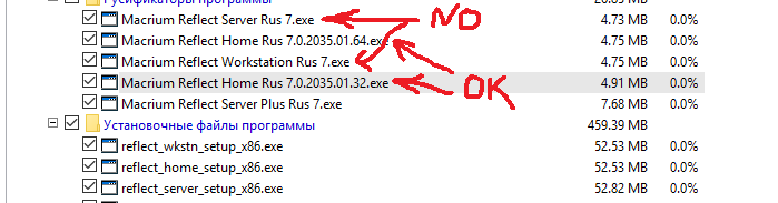

2) Open this torrent in SIMPLE LIST mode and you got the names:
Macrium Reflect Server Rus 7.exe
Where is the tail - ".0.2035.01.32.exe" ???????
and
Where is the tail - ".0.2035.01.64.exe" ???????
This is a bug in names! And if I try to download these files I got a HASH error always.

There are no file with name "Macrium Reflect Server Rus 7.exe" at all, but BitComet show it !!!

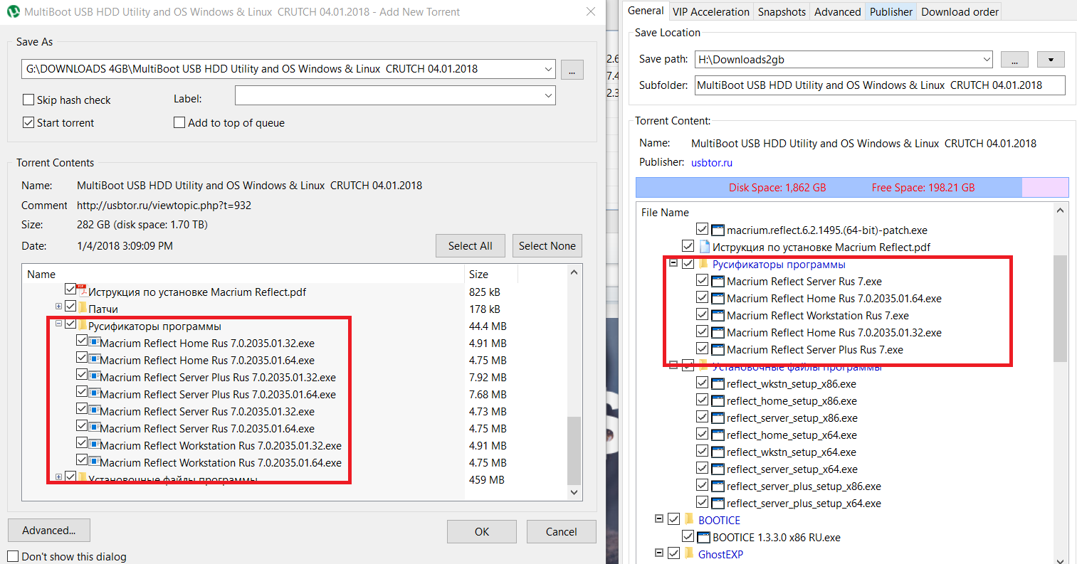

Please compare with uTorrent list. Please see the picture attached.
It has no file "Macrium Reflect Server Rus 7.exe" but BitComet show it !!!

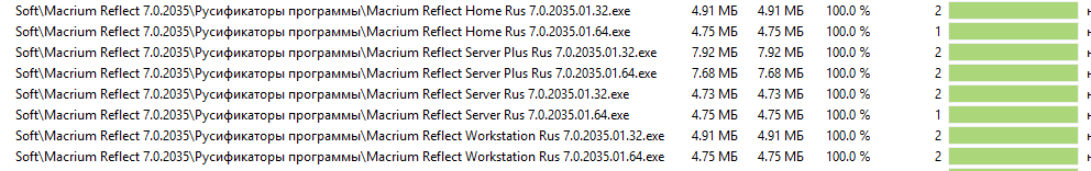

Torrent has two files:
Macrium Reflect Server Rus 7.0.2035.01.32.exe
Macrium Reflect Server Rus 7.0.2035.01.64.exe
But BitComet has a bug in function for parsing the path/name/extension and parse these two files as one file:

I believe there is a bug here. I didn't want to download nearly 300 GB to test it, but just loading the torrents in BC and uT shows a problem, 2 of 10 files are fine, the other 8 are both truncated and combined into 4 files. I suspect because they are so deep they exceed the max length, but that is just a guess.
I will report it to development team
